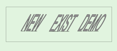

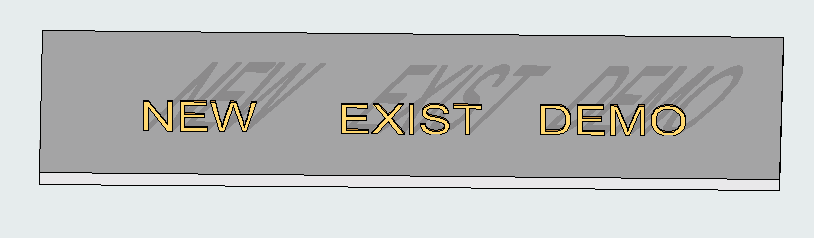

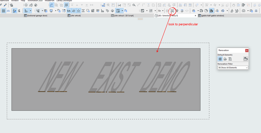

So you do a 3D view of your building with the shadows on and all reno status showing.
You 'look to perpendicular' to get a plan view.
Change the 3D style to 'Basic" so you can place a marques and 'Copy' the shadows.
Now you can paste the shadows into your plan and align them with your building.
You will want to make sure all of the fills are pasted as 'Existing' or a reno status that is showing for the plan that want to show the shadows on.
You could change the fill colour for new, existing demo if you want.

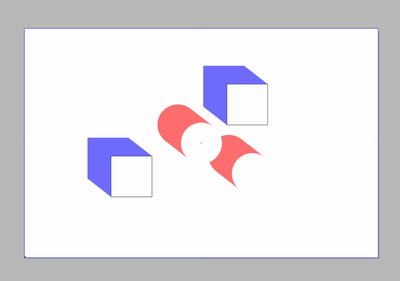

You don't need to copy and pase anything. What you've got with the 3D documents is a live view from your shadows that will update with any change.
Here's a video:
Final result (blue - new construction, red - demolition):
