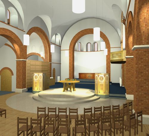

Hi
We are a tiny practice and don't do much visualisation at all. So this is all a bit new for us. Would love any feedback you can give. This is straight outta Lightworks in ArchiCAD.
Cheers.
Dwight
If you intend to do any LightWorks illustration, you need my book. It will help you:
- turn off the idiotic camera light.
- put some color in your lights - yellow and blue.
- convince you that THERE'S NO SUCH THING AS WHITE.
– not rely so much on ambient light that flattens space.
- texture the walls so they aren't so scalded by direct light.
- add darkness and drama.
because these are the main flaws in your image.
Dwight Atkinson
Linus wrote:
...Would love any feedback you can give. This is straight outta Lightworks in ArchiCAD.
How about making a custom texture for the sides of the brick archways so you see the bricks curving around? Or maybe even use the 'Masonry Arch Segmental' library object which uses tapered bricks, rather than normal bricks with tapered joints?
Yes, i thought you'd say that =] I'm sure you're right. Its on my shopping list for some point in the future. Thanks for the advice, tho, which has helped a lot. I did have colour on most of the lights but they were getting swamped by the ambient, which is now down at 50% from about 150%!. I've turned off the camera light (it was already down at 25% - some of the glare on the ambos is coming from the photo taken on site, unfortunately, not the render settings). I've also changed the walls to have kind of a dialled down version of the stucco finish, rather than being totally flat, think that's what you meant. See next post for more drama.
Thanks, hadn't thought of that - The poor representation of the brick arches is the thing that's bugged me most about the model. They're currently made using complex profile and a curved wall, turned into a very dirty gdl object, so there's not much scope to get the textures to look right. Using 3 or 4 of the Masonry Arches on top of one another might work, and i'll give it a go this w/e if i get a chance.
