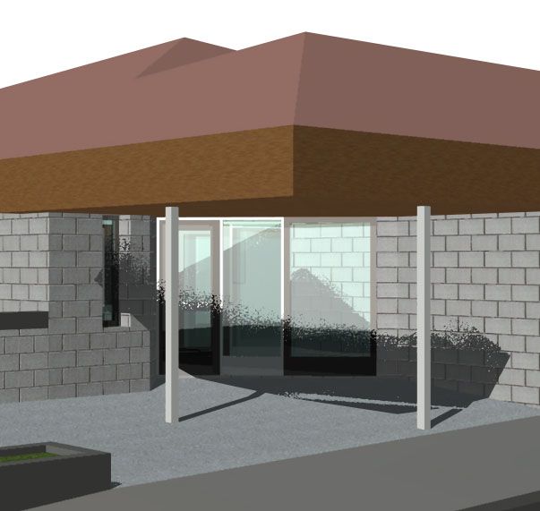

Does anyone know what causes this strange shadow (see image)

Changing the “Shadow casting” in the Photo Rendering Settings from “by lamp settings” to "Hard" seems to eliminate the problem.
PS Strangely if I uncheck the “Transparency” in the Effects, the problem is also eliminated but so are all the cast shadows!

try the realistic sun shader
a little pixelation but much better, incredibly slow though!
