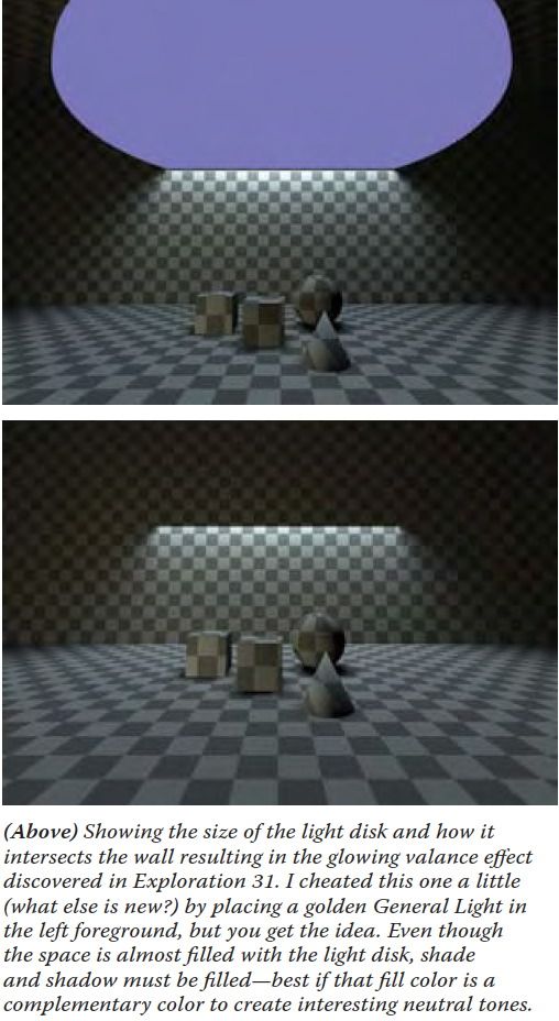

You are correct that there is no fluorescent or strip lamp in Archicad. Point source only, except that the origin 'point' can be made large enough to emulate diffuse lighting. Park a large diameter light cone down half way into a wall to create the look of a strip light.

I am also trying to achieve this effect. Cant seem to replicate it, though. Should the light be angled at all or straight down? Can you send a screen capture of the lamp setting you used to achieve that effect?
Thanks!
Dwight
tilt toward camera to illuminate room better.
At least a 3m start cone.
from page 69 of "LightWorks in Archicad."
Dwight Atkinson
Can you show your Lamp Settings window to further demonstrate how you created this effect? Thanks!
Archicad 14
Dwight
Buy the book or experiment.
