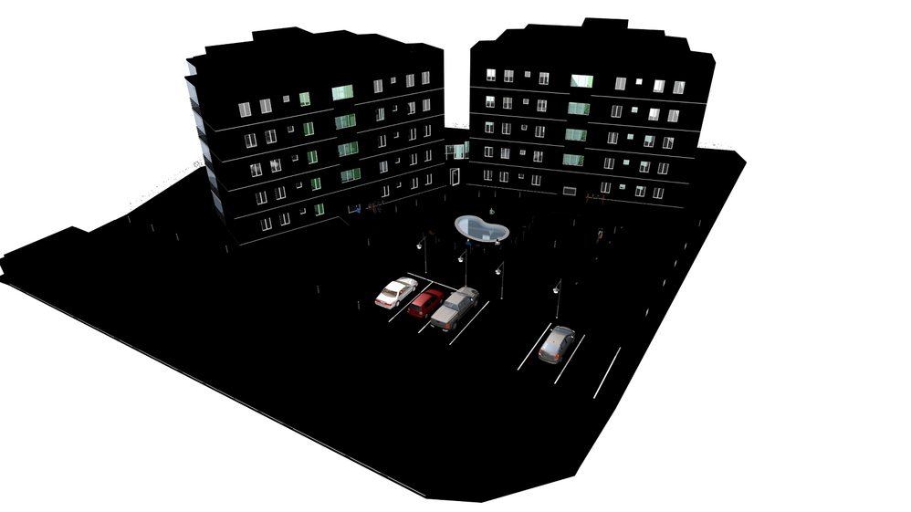

I've been trying to render with LightWorks Engine, but the result is, well, very dark.
These are my settings:
http://i42.tinypic.com/2073ogi.png
What is wrong?
Thanks!
2 Replies 2

Noktok:
Since the cars and pool are showing, its looks like a problem with the Material(s) assigned to the walls, roofs and grade. Check the settings of the Materials assigned to these elements under the LightWorks pop up in the Materials dialog box. If the Internal Engine settings are good, then you can start with the Match with Internal Engine button.
David
David Maudlin / Architect
www.davidmaudlin.com
Digital Architecture
Dwight
And once you fix the materials, turn off that stupid camera light.
