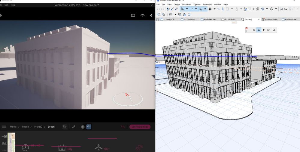

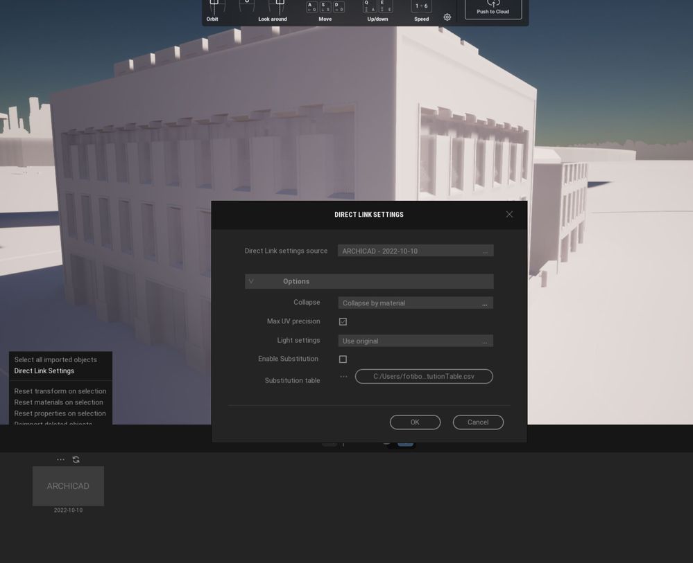

Hello Minh, I know this is an old issue, just installed all the latest twinmotion and plugins 2022 and dataexporters but I seem to see some missing parts. I dont have that "optimize the geometry" in the direct link settings.
Foti B.
AC25
PC Precison 5760, Xeon 11955, 64GB, Nvidia RTX A3000
The original post was talking about the 'Direct Link' add-on.
There is no 'Direct Link' add-on for Archicad 25.
You will have the 'DataSmith' add-on?
This may be completely different - I don't have it installed so can't say for sure.
