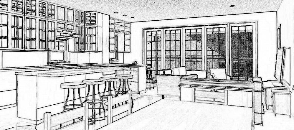

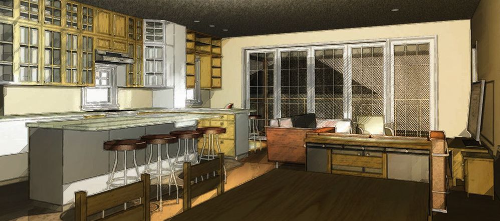

rob2218 wrote:For a really sketchy look you can shoot the same view with both the sketch and photo renderers and overlay the former onto the latter in Photoshop. For this to work you have to knock out the white space from the sketch layer (magic wand in Photoshop) and (usually) tone down the colors in the photo rendering. I usually do the latter with and adjustment layer (transparency/brightness/contrast) in between the sketch and color layers.
thanks Dwight!
Yes...meant to look more like a "sketchy" concept idea vs. a photo-real rendering.
thanks for you comments. They help.
