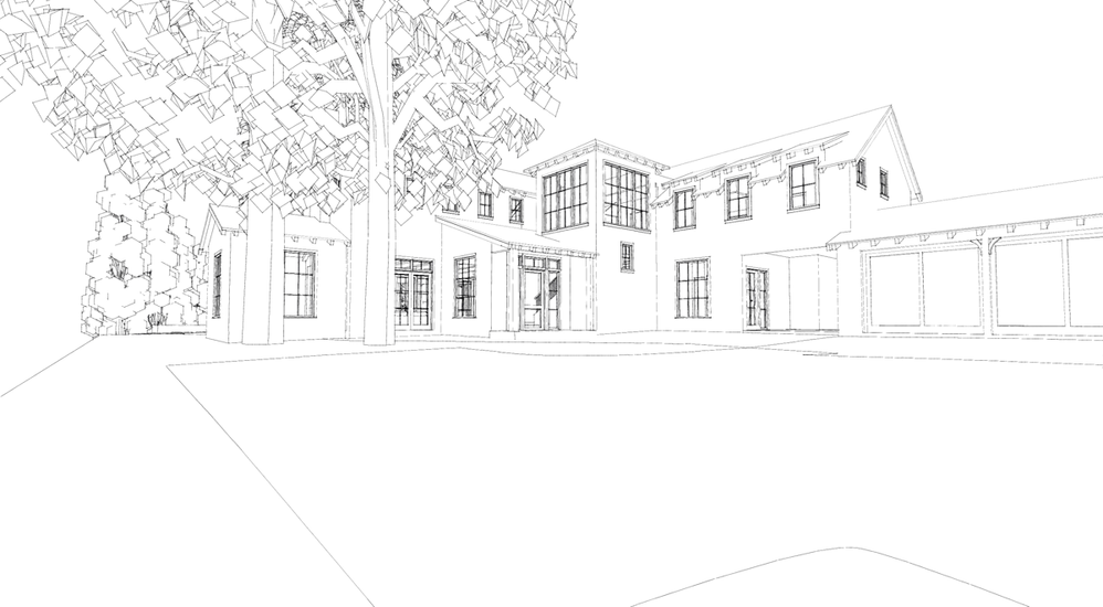

rob2218
this rendering took 10 seconds....when I click on the "shadows" radio button.....it comes to a grinding halt...WTF?

I suspect that 3D has a high polygon count because of all those tree leaves. When you turn on shadows, it tries to generate all those shadows of all those leaves, which increases rendering time dramatically.
rob2218
OK...I'll try to render tomorrow "without" the trees turned on ......see if that helps.
thank you.

Rob,
You can turn off the shadow casting for the trees within the settings for the trees if they are standard ArchiCAD trees.
If you need the shadows from the trees on the ground etc you could render a view with a simplified version of the trees and then composite the two images in Photoshop (or if on a Mac Pixelmator)
Regards,
Scott
rob2218
I'll try to turn off the "shadow casting" on the tree objects themselves.
then I'll try creating the sketch without the trees all together....I'm not sure what changed but before.....the sketch render technique used to take seconds....now it's hoggin'.

rob2218
here's where it hangs.
see attached observations.

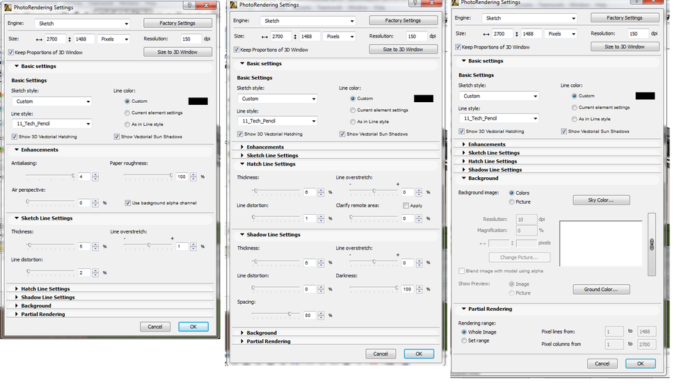

rob2218
here are my "sketch" settings by the way.
I can't seem to figure out WTF is causing the sketch NOT to render quickly....

rob2218
here
