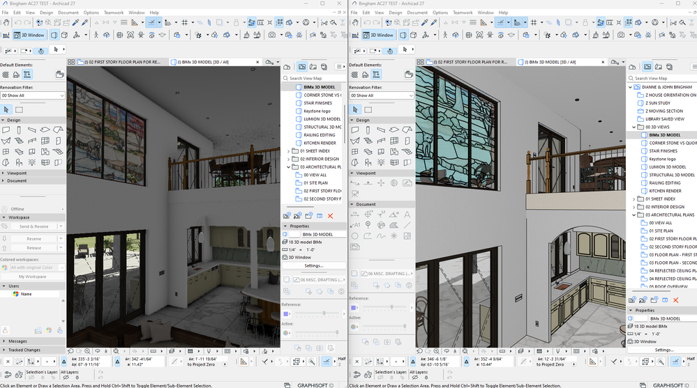

I have been testing the technology preview with some of my files and I opened these files today in the actual release.
The 3D window settings are awfully off. Can somebody help me to understand why this is happening?
And if there is a global setting to create at least some 3D styles with the old look?
Please see the screenshots:
1. Left is AC27, right is the technology preview. Exact same file, exact same 3D style settings.
Stained window transparency off, contours off, although settings say they are on. Super dark and pixelated, like 3D antialiasing is not on (it is). And the shadow casting on the patio...
2. Surfaces are displaying wrong: (left is final release)
How can the black fridge and the white cabinet fronts have almost the same color? No overrides are applied, and I checked for missing surfaces.

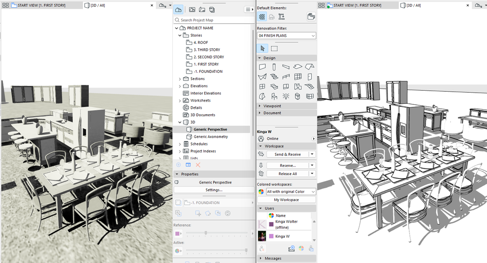

3. It is even worse when I apply the White Model setting:
Still no contours and there are textures applied, just greyed out on a white model?

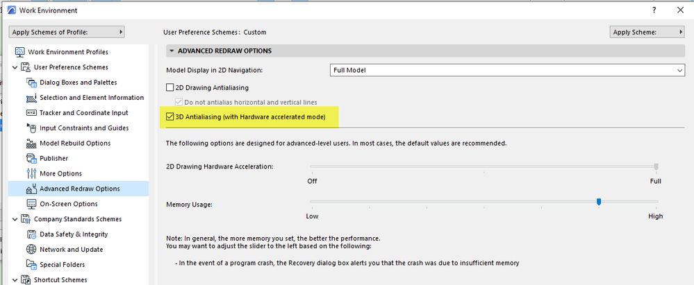

Is the contour line pixelation to do with the 3D anti-aliasing setting in the WE?
Hi Barry,
Unfortunately no. It's  been on in both files.
The left is still in AC27 release, the right is in the technology preview. Same file, same WE, same settings for 3D window.

This helped me getting back original light, shadow casting and surfaces. I still find the contours more pixelated than in AC26 with 3D Antialiasing on, but at least it is presentable straight out of Archicad. See screenshot below.
