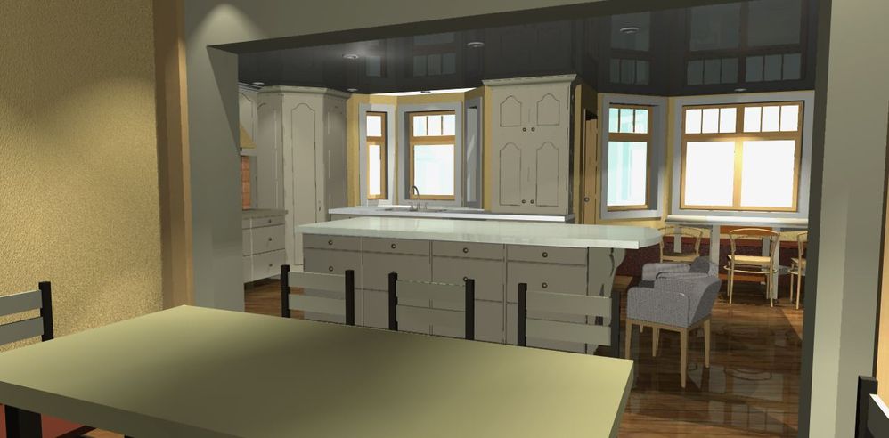

Please see the attached images. Fairly self explanatory. Does anyone know what I'm doing wrong? I'm sure it's a silly oversight on my part, but I can't figure it out.

Here's the unrendered view.
What are the material's settings?
If you are setting up the materials with the internal engine settings (which is what AC uses for the OpenGL views) make sure to match the Lightworks material settings. There is a button for this in the Lightworks settings.
Be careful about reflectivity though. Even a modest amount of shininess in the internal engine settings can be translated into a "mirror" setting in Lightworks. I often have to reset this to "metal", "multilayer paint", etc to get the effect I want.
I'm not sure what fixed it, but I started over, made sure I checked "match internal" properties, and then fiddled with reflection and so on until I got things straight. I also added a bump map and texture to get a bit more interest. Thanks for your help.
It would have been the "match internal" that did it. The colour (and maybe ambient / diffuse) settings obviously did not match. Now you just need to tweak the bumpiness. It currently looks like the horrible textured ceiling finish I have in my house - must get up there and scrape it off one day.
