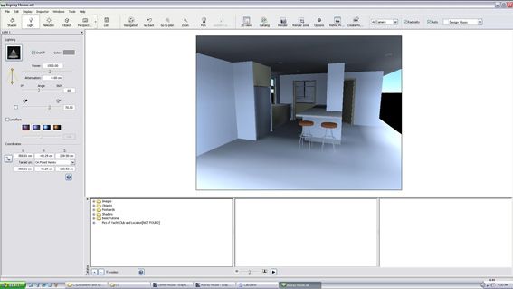

Hi guys,
What am i missing here!! I've attached a screen shot of my model in Artlantis, how do i: A) add lights in Artlantis and B) how do i control the ones I've exported from ArchiCAD?????
Thanks
vfrontiers
Turn on the CONTROLLER palette...
1. By clicking on the LIGHT icon in the TOOLS
- A LIGHT GROUP(or groups) will be displayed in the CONTROLLER P.
- Check to see if there are ANY LIGHTS here... if not, they did not export
- If there ARE lights and they are in regular font...
- Right Click on the GROUP NAME and choose ACTIVATE FOR CURRENT VIEW
2. You can also open the 2d VIEW dialog and look for little YELLOW dots in plan view
- If the dots are DIM yellow... light is NOT ACTIVE IN VIEW (see above)
- If light is DARK yellow... light is ACTIVE
3. If there are NO LIGHTS (actually there may be one default light)
- Either the LIGHTS in ArchiCAD are not REAL LIGHTS (just fixture objects / no light source)
- Or your EXPORT has them switched off (see previous posts)
4. If you see there ARE lights, SELECT ONE and make sure you're in the LIGHT TOOL
- Check the setting of each light to make sure they are ON (there's an on/off switch)
- And make sure they have power..
In your scene, it will be difficult to see the effects of the light since your SUN is on and providing light.
Anyway... run thru this list and let me know if there is any news...
