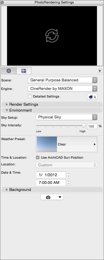

Can't find date and time for render settings in archicad 20

It is right there as per your screen shot.
You have to un-tick the "Use Archicad Sun Position' box to set it manually or it takes the settings from Archicad 3D Projection Settings.
I think there may be a bug where the date and time is adjustable when use Archicad settings is ticked but as soon as you un-tick and then tick again the box they become inactive.
As for the screen resolution that only applies when you have the 'Size' set to 'Print (Portrait or Landscape)'.
It is not applicable for 'Screen' or 'Size to 3D window'

I didin't have that option in archicad 20, but After updating to the latest build it came out, thanks
