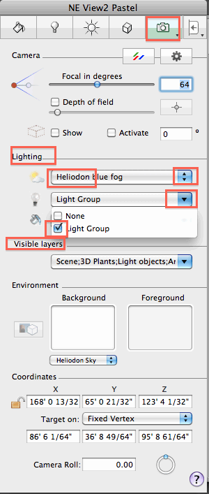

You have to understand that Artlantis has views, somewhat like ArchiCAD. So, in the Perspective Inspector (shown below), you can choose which of several heliodons (suns) to use and you can enable as many (or none) light 'groups' as you want, as well as control layer visibility. All of this is saved with a view. There are perspective, axo and many other views.
So, if you do not have a heliodon selected and your light groups checked, it does not matter if the lights are on in the light groups, or that the sun is bright - nothing will be lit.

Lights in Artlantis are created in the Light Inspector shown here. You have 9 basic lamp types to choose from as shown ... then power, color, falloff, etc ... and of course location. By opening the 2D window, you can position your lights within your ArchiCAD fixtures.
You can drag multiply existing lights and more ... see the videos on the Artlantis web site ... a lot of useful training tips there. Note that you can lock (the padlock icon) a light or any other object so that it can't accidentally be moved once you have it where you want it.
You can name/rename your light groups and add lights to them by opening the 'tray' seen in the screenshot.
