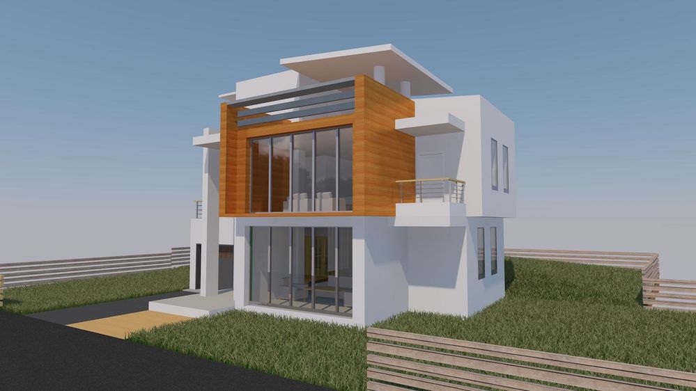

here is a test render for a tutorial about Cinerender that I am working on to be published soon.

Nice glass!
I have and had several problems with the glass.
Sometime it appears as opaque.
eng. Alessandro Mandala - Italy
AC27 latest hotfix
Win 11 Pro 64bit
Ultra 9 275HX 64GB GeForce RTX 5070ti
MuazOnline
it's more than one issue to get Opaque effect on the glass:
check:
*- Lighting (you have to have GI Global Illumination activated)
*- transparency should be too low or too high
*- increase the value of Ray Depth parameter
*- if you're working with external shot you have to add HDRI image to the Environment channel
*- your lighting sources should be configured so they match your camera (external or internal)
that was to name a few causes of making Glass material Opaque. hope it would help
