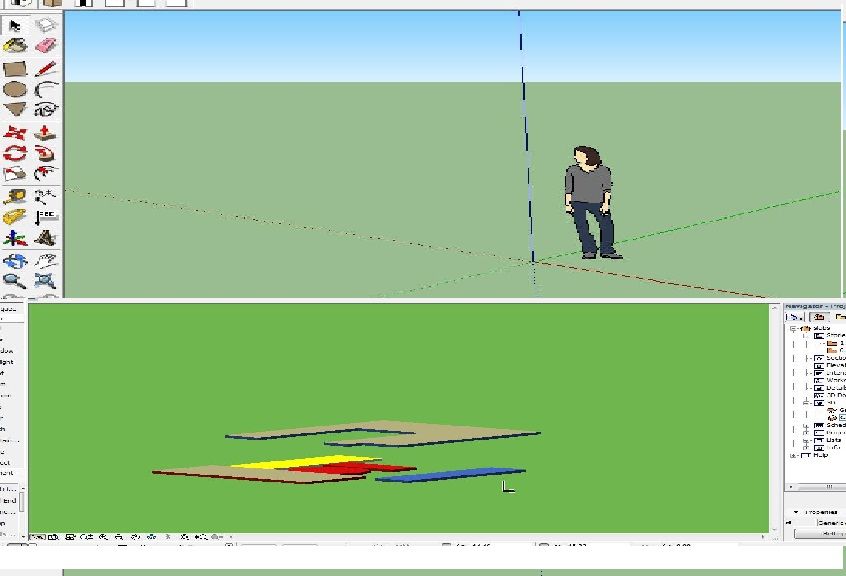

how can i change the background of 3d environment from white into 2 colored one plane and one sky like sketchup
so i can see it close to reality when i click show 3d
i need this without have to render because this can give me more ability to imagine in reality like sketchup

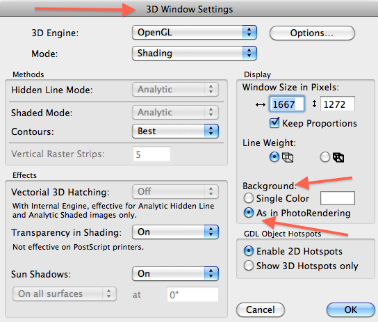

Open the "3D Window Settings" dialog. One easy way is to right-click out in space while in the 3D window. See attached - change the Background to "As in PhotoRendering"...

Hello Karl , You are right and it was closed but for sorry as you can see the 3d either appear with this color Green for example or with blue not both of them appear together As you can see in the image i make 3d without render but one color only shown although i made it in a level that will show both (this is unlike sketchup) so sad.
