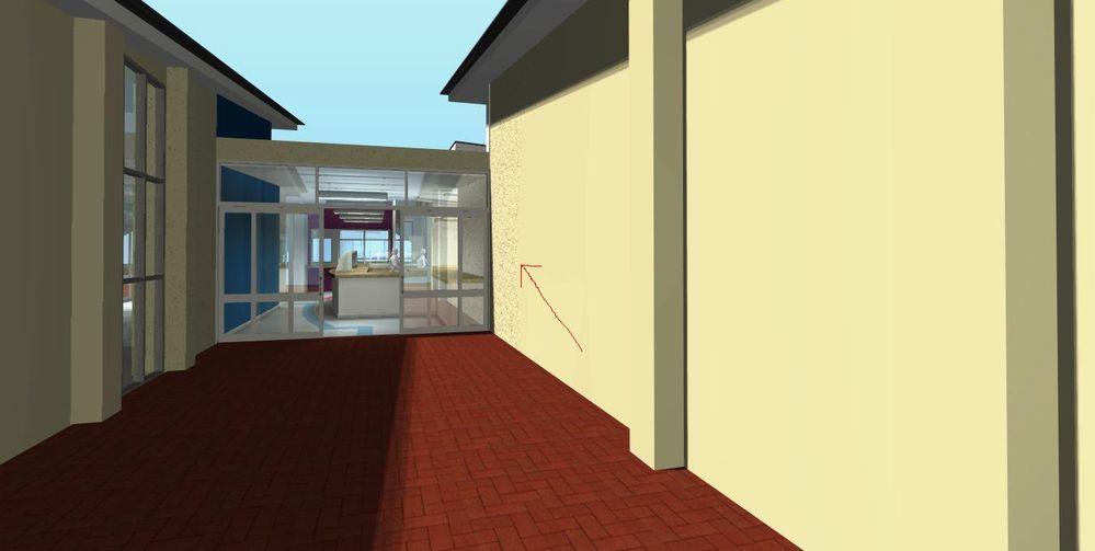

I am having problems with the displacement of the material not rendering in some parts.
The material is just a plain colour, with a simple matt reflectance shader with casting displacement.
This building is actually a hot linked module
The model is Very large, but even when i marquee the particular area this still happens

What sun are you using and at what sampling rate?
What anti-alias and what render quality?

i am using the setting as showen in the image.
and then a sun object with 15 samples and 5' of diversion.
these are only process renders, for the final i usually crank the setting up to best anti-aliasing and 3000 x 1500 res.
could it just be the anti-aliasing quality that is giving my poor texture reproduction

Sun gets complex after Archicad 9 - you re probably doing the wrong thing with the sun. Try the Sun Class Shader "Realistic Sun" and thro away the sun object.

Yeah i am now rendering with the realistic sun with the same results.
and i have supplied the results.
this is happening with a few textures, usually ones of large surfaces (outsides of a building)
have you ever had any problems with the casting shader?
the shader values are quite low?

increase realistic sun sampling.

well, it is one thing to have a surface look a little rough, but to have real stuff disappear in the foreground - alarming.
ARE you SURE that the wall is correctly surfaced?
