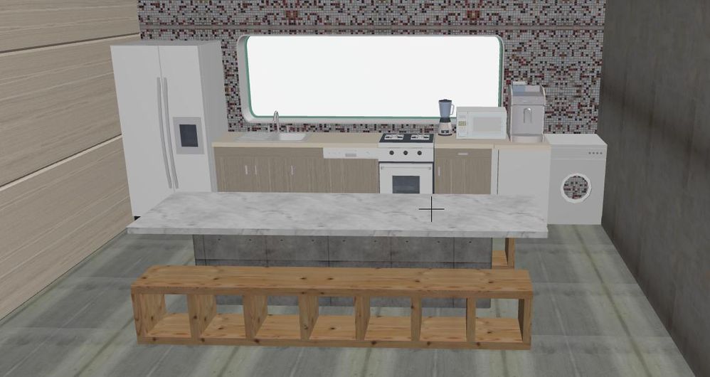

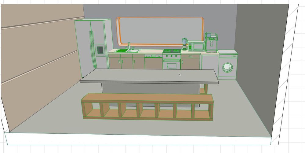

I've modeled my building with different materials and I am trying to export an image from the 3d model but the image comes out without the textures and with the contour lines of the objects showing, I am attaching pictures to show you what I mean..

This is what my image comes out looking when i use Capture window for 3d document.
Dwight
3D documents are created with the internal rendering engine, not OpenGL. It is incapable of showing textures.
You'll be limited to 2D captures if you absolutely need textures.

If you are doing a Save As image file from the 3D window in Open GL mode, you can turn off the contours from the 3D window settings. That would provide you the "clean" capture from 3D window I believe you are looking for.
