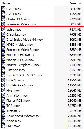

Hi Jeff
I have found the Sorenson Video compression engine to give the best results, which is a balance of quality and small file size. Attached is a comparison list based on a VR of a basic building. You can see where Sorenson Video sits in the file size list and it's quality was comparable with it's much heavier counterparts.
Hope that helps.
Cheers,
Link.

Wow! Link, H.263 came in with 697 kb compaired to 3018 kb in Sorenson3!-- hopefully the PC world soon adopts this Apple standard.
For now, in order to maintain compatability Sorenson3 is best.
