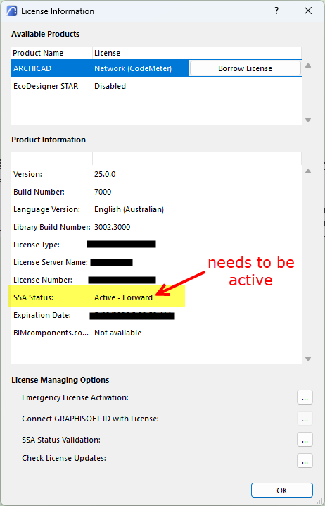

You say you are using version 25.
Do you have an active select agreement (SSA)?
If you do not, then I don't think Redshift will be available, no matter what hardware you have.
Have a look at 'License Information' in the HELP menu.

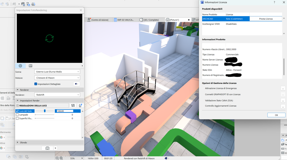

strangeday
Hi @Barry Kelly, I switched to Archicad Collaborate from SSA(Archiclub in Italy), anyway I'm quite sure that this is not a license problem, because RedShift works well on my laptop that has an NVIDIA RTX 3070 Graphic Card,
 As said in the other tread, there should be an honest statement by GS, I've also tried to ask to GS Italy, but they has no solution(Their response was very annoying, frankly speaking, saying that the feature is a preview so it's not guaranteed to work for everyone🤣🤣)
Francesco De Meo | Architect | AC 6.5-28 | Latest build | Win 11 Pro 64 | AMD Ryzen9 9950 | 128 Gb RAM | ZOTAC GAMING GeForce RTX 5090 32GB
