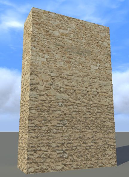

I suspect the tiny low resolution bitmap stamp is a relic from the days of seriously handicapped computer memory. I've been using increasing larger bitmaps in recent years, sometimes as large as 4000 x 4000, and I haven't found the memory ceiling yet. I'm sure it slows rendering down a bit, but not nearly as much as gigazillions of polygons and light sources.
