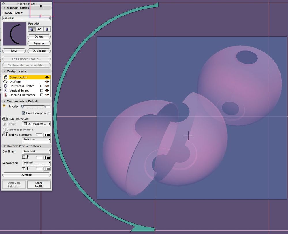

Hi, I'm a second year undergraduate student majoring in architecture, and for my current project, I am designing a three-story multi-spherical building. I was wondering how I could draw such a building in ArchiCAD. Since the building is a sphere, that means all of the floors have different areas, which I could draw on the separate stories, but how would I connect all the floors while forming a smooth spherical surface. Also, I am using a steel geodesic structural system for my design, is there anyway I could show that with ArchiCAD such as with a certain material or something?
Thank you in advance.

First of all, there's no such thing as a spherical building, even if Archicad has a sphere object in the library folder "Special Construction." Or, that you could make a Complex Profile half-sphere and use it with a curved wall to define a sphere that would possess more built information than a fantasy sphere might. [see illustration attached]
A building that is spherical would be made of many flat segments - like a geodesic dome appears to be a sphere but is sticks and tilted flat panels. No curves there at all!
I remember a GDL object somewhere that was a Geodesic dome - perhaps one of the objects with the GDL Cookbook.
If this is a multi-storey structure, you could use the complex profile/curved wall approach to guide and define floor areas [floor plan cut height] and then replace it with arrays of tilted columns and triangular roof planes as interstitials.
Archicad doesn't map textures to curved or angular surfaces well, so trying to emulate the 3D with a surface won't do the trick for you.

Yes, a geodesic dome is formed of a series of many triangles that may combine to form hexagons, pentagons, etc. I understand that there are no curves, I suppose I should have worded it differently.
I'll try what you suggested.
