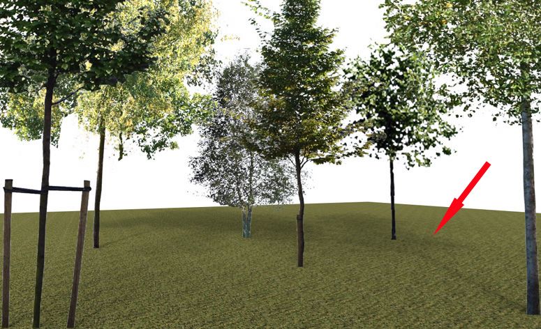

i am doing exterior site renderings with multiple buildings now, but i think this will pertain to all my renderings - interior, exterior, where ever
how do you get the shadows cast to be less intense.. (lighter, more transparent)
i have experimented with the sun settings, and the rendering settings
and it doesn't seem to make a difference...
some objects left in the shadows are lost in the image
help

Increase ambient light level.
Add extra manual sun object to fill shadows.
