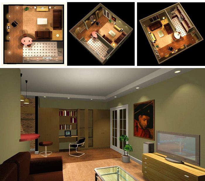

heres a couple of pure lightworks renders, (except the borders and titles etc)
Mike
Another 100% ArchiCAD and Lightworks.
Comments, criticism and suggestions most welcome.
Mike
Dwight
The interior is a good start, but it has the character of a cloudy day. Can you make the sun penetrate the space?
Lightworks does tend to the murky. Try yellowing-up the light colors.
Find some way to add dark surfaces to balance the light ones.
Dwight Atkinson

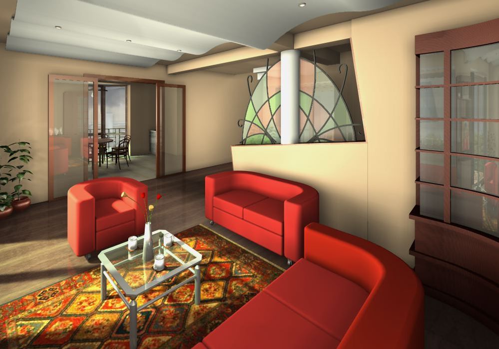

Thanks Mike, your works look great too. You did a great job but have you enjoyed the process itself? Have you spent reasonable amount of time?
The "sunny day" renderings usually come out nice and LW works good enough. But when it comes to electrical light it gets more challenging and time consuming and the result is not even close to ideal... Its really hard to find this tiny border between under and over exposure. Neon effect - impossible without photoshop. Extremely long time to render the scene (if not crushes or out of memory) in HiRes and then saving to JPG with "best" quality, clean-up, touch-up... Oh, my...
Attaching some more 100% LW shots from recent past.
Regret I didn't use Artlantis those days....
Regards,
Sergey

Dwight, I will adjust the scene with you recommended changes and see how we go. I'll also send you the file as requested.
Mike

the announced pictures are here.
Another one
I like your axo apartments scenes.
Mike
