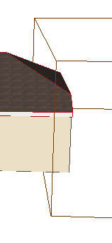

OK. Never mind the code. This is either a bug, or simply an oversight by the GS programmers.
I have a GDL 'box' that simply moves to the 'left' on the X axis 1 foot per frame. The SEOp subtract shows at the starting position. However, with the box completely visible (but on a wireframe layer in order to observe the behavior) and with the 'rebuild model for each frame' box checked, I can watch the wireframe move over my model, foot by foot, but the subtraction is not updated.
A further issue/bug is that when an animation is complete, the dynamic box's position is shown as it was in the last frame, yet the frame number is supposed to be reset to 0 and the 3D window rebuilt when an animation is complete. Manually rebuilding the 3D window has no effect. Closing the 3D window and reopening it is the only way I can get the window to rebuild properly. (It is not a display driver issue - it will rotate with the incorrect information shown. Why would 'rebuild' fail, yet closing and opening the window work?)
Attached is an image showing the 'cube' at frame 5 (5' into the model), but with the model cut at the original position of the exterior face. This is not even an animation at this point...but the 3D window.
So... I guess we're back to the save-model-as-object approach from years past.
Karl
