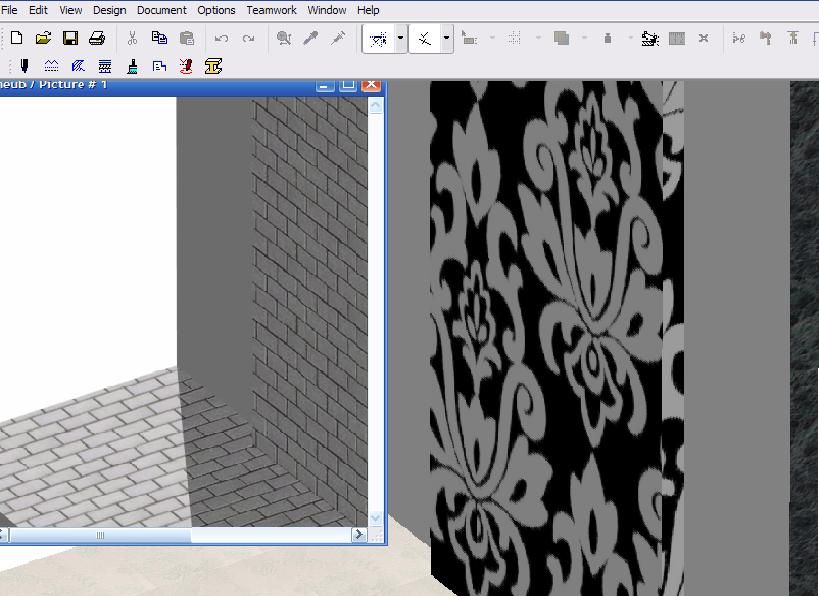

Dear all,
here i am again with another prob.
when i do create a Photorender projects i don't see the same materials i used.
does anyone got an answer for this.
please see the attached pics to understand better my prob.
thanks
archicad 12
4 REPLIES 4
Assuming the difference you are showing is between the OpenGL in the 3D window an the results of a rendering, I would guess that you are using the Lightworks engine and the settings for the material are different from the internal engine (which is what OpenGL uses).

ar_raneem:
In addition to Matthew's reply, there is a button at the bottom of the Lightworks Shader Settings in the Material Settings dialog box to "Match with Internal Engine".
