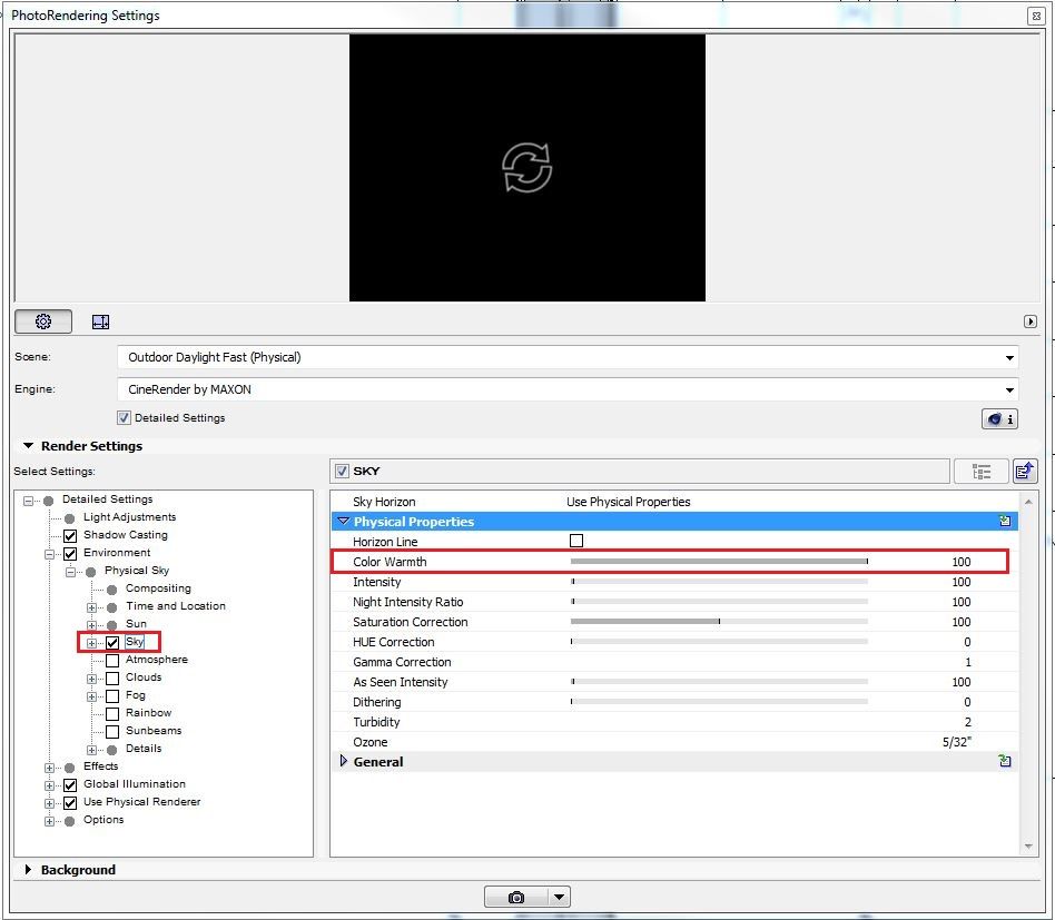

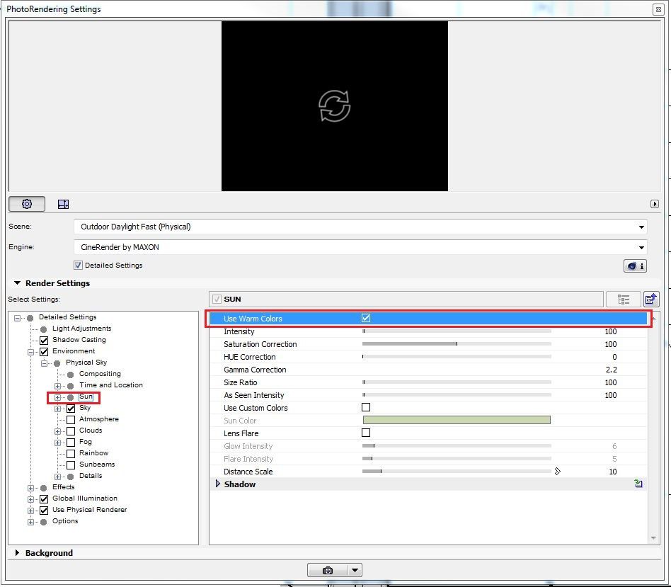

Hi, Rob, two things come to my mind, I don't know if you try it already.
One is the color warm in the sun and sky parameter, the ones shown in the pics.
The second one will be adjusting settings in the effects, color correction and color mapping tabs.
Here is the other Pic

thanks Rivas.....I adjusted the "warmth color" of the sun and that helped.
