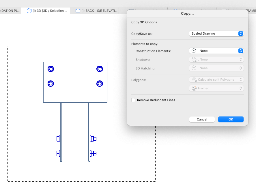

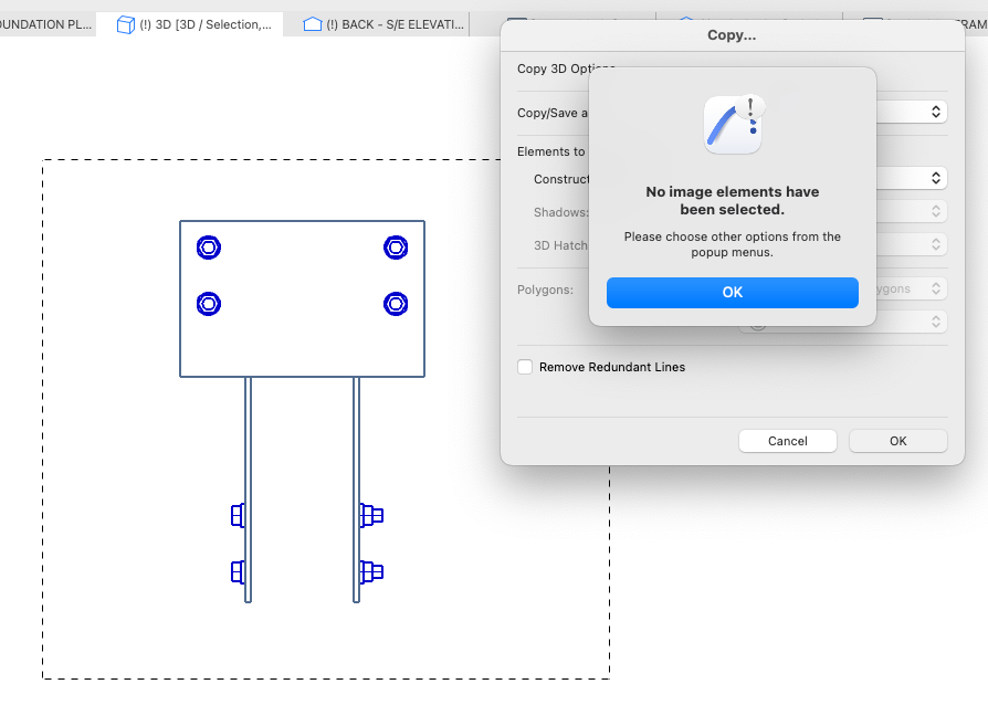

used to be able to copy a scale drawing from the 3d view  to paste into another drawing is that no longer allowed or how can i do that
 I'll attach what my computer gives me
working in archicad 27 a user since 4.1 in 1992 on mac book pro
Screenshot 2025-04-03 at 8.57.30 AM.pngScreenshot 2025-04-03 at 8.57.17 AM.png

Can you select the "Edges" option in the "Construction Elements" field?
Go to post
2 Replies 2
Ron
thanks that worked, guess i should have tried all the pull downs but I never had to before
