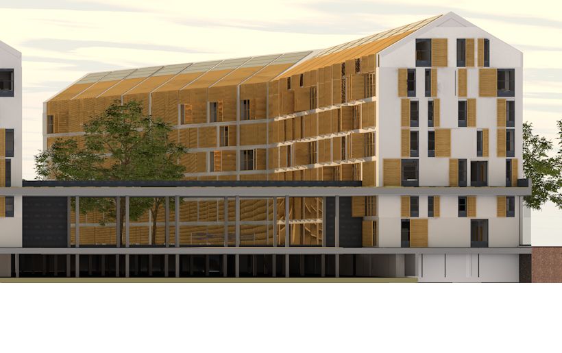

Hi.
Im having a problem rendering this view. As you can see on the image, shutters are strangely distorted. At first I thought that it is a glass render settings problem, but it keeps rendering like this even if I put only empty window openings. Could anyone help please?
Thanks.

What version of AC? Which rendering engine / settings? Are the shutters standard library parts, if so what is the name? If not, how were they modeled?

AC 18, using cinerender
Shutters are downloaded from bimcomponents, I believe that it is an american equivalent of sliding folding multi panel (has more door panels to choose from).
As to settings, Im using basic settings, I had to turn off colour mapping , exponential to hide transparent tree boxes.
no problem with the shutter,
it's just an issue of "moirage" (name of the effec ctrated by the view of thin parallel lines in a perspective when missing enough detailed resolution.
solution: increase anti aliasing AND resolution.
good luck
Okay, wil try. Thanks
