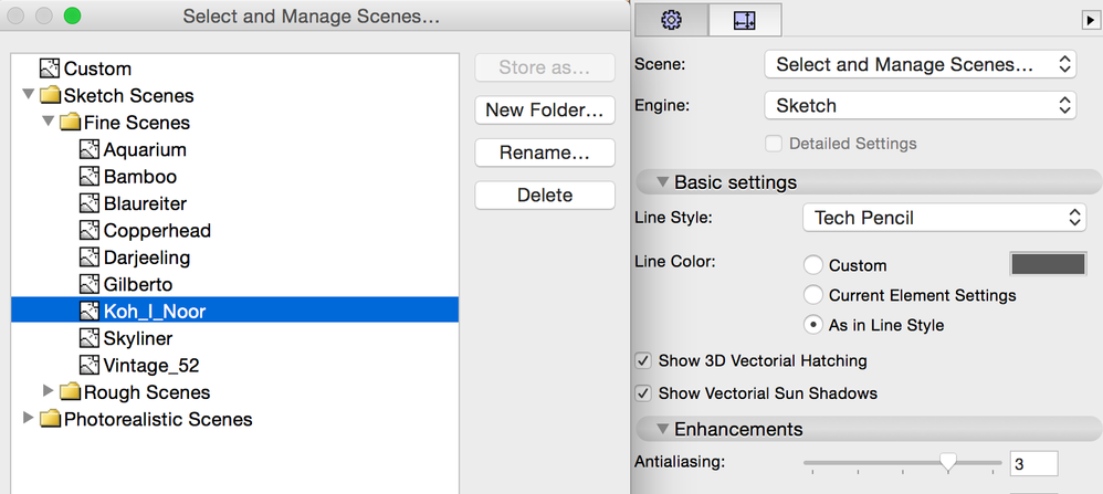

I´ve been using the koh-i-noor setting for doing sketch renderings but since the update to archicad 18 (both student version international and austrian), this setting is no longer available!! Quite a problem, cause it´s the setting I´m used to… Anyone knows why is it missing or if it´s just a configuration problem? Is it generally missing or just on the student version? Thanks for your help!

Missing also from the defaults in the Pro version but if you select "Manage Scenes…" you should be able to find it.

Thank you ejrolon! Saved my day
