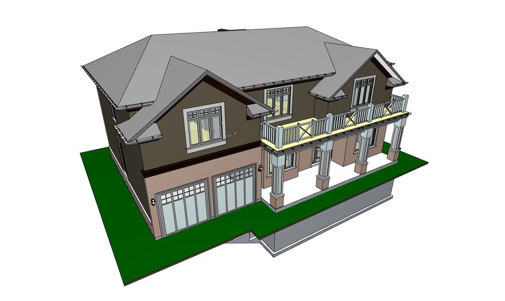

I'm getting texture weirdness as well. I didn't use v15 but I am having the textures not apply similar to above as you can see in the following pics in v16.
To fix it I have to open the material manager and I usually adjust the transparency on the the first material the pops up and set it back to where it was then close the material manager and when I do that the engine regens the model and the textures reappear. But adjusting any setting on any material resets the on screen rendering. This happens to me frequently. My sig is up to date and my computer was recently updated so I'm 99% pretty sure my vid drivers and such are latest so I can say I've had this behavior before and after updating.
undefined
After resetting with the material manager trick.
