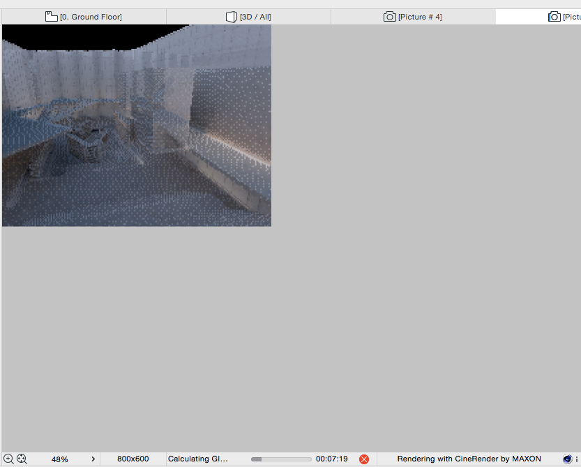

urgent help about processing image
Hello
I have some problem in rendering
after this scene it does not processing the rendering image with this screen...
how can i do?

With complex lighting the calculation of GI (=global illumination) might take a lot of time if settings are high, or sometimes even at medium settings it can take from tens of minutes to hours. Just wait, or stop it and lower the rendering settings.
It all depends on your machine config too, You did not mention your OS version, AC version or any machine specs?

My one is OS version.
In same condition it operated well with the other model.
it might be the problem with the file size ?

If the render stops, that ussually means you ran out of memory. I'd say you need at least 16 GB of RAM to render most reasonably detailed scenes.
Here are some tips I gave on another topic to set up a reasonably fast render, which will still give decent results: http://archicad-talk.graphisoft.com/viewtopic.php?p=267934#267934
