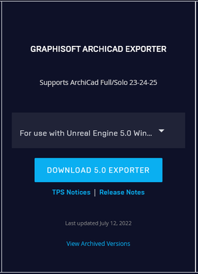

... speaking of, any news from Unreal when the export plugin will be available? Their web still says 23-25... https://www.unrealengine.com/en-US/datasmith/plugins
