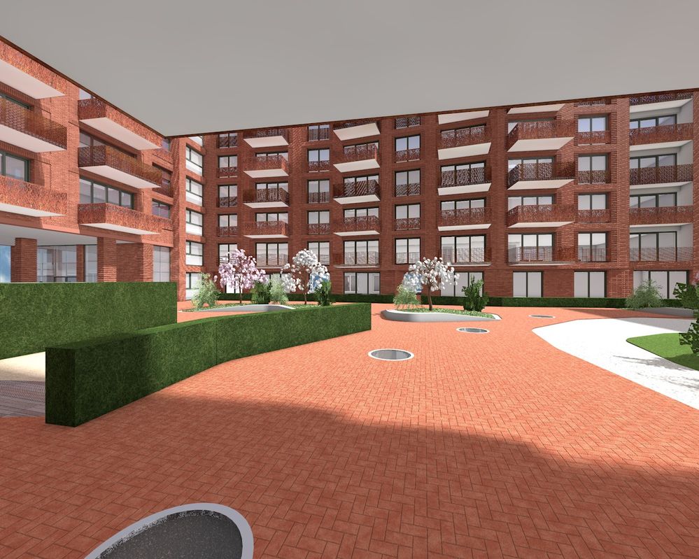

how do i make the white surfaces (the undersides of the balconies) in this scene not reflect the red color of the floor tiles? i would like them to be plain white
and another thing: how do i brighten up those shaded areas in the background?

i'm using cinerender on archicad 19 btw 😉

Well, unless the surface material has a reflectiong, specular or the like settings, that would be where I would look to fix the colour.
Are you sure it's not the brown sky rather than the pavement?

It's definitely the pavement color that's being reflected. i just changing the pavement color to white:
i found the solution! it's in the GI settings of the Surface (the red pavement). you can control the Saturation Levels of the generated GI of each Surface! i set it to 0 and voila!
the Surface still has GI effects on the surroundings but it's color won't be reflected on other surfaces
