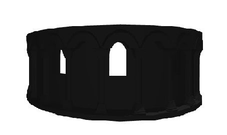

why the render dosent show the material
i imported a 3d object ,but when i want to render that object,i cant see the model matterials
can u help me whit that?

How did you import it and are you able to change the materials in the imported object's parameter settings?
Three possibilities that occur to me:
If the import is 3ds the ambient light parameters for the internally defined materials are probably set to 0.00. I don't know why this happens but I get it consistently when importing from SketchUp.
If you are rendering in Lightworks it may be that the LightWorks material doesn't match the OpenGL.
You don't have the scene lit (ie no sun object in LW).

I can change the material, but it would never be the same as the original one

Another possibility is that you are lacking the texture, or you have it but it is not in the loaded libraries. I'm not sure why it would render black in this case unless that is the underlying color in LW.
More details would help to understand the situation. Like type of model, renderer used, library part edit window (screen shot), etc...

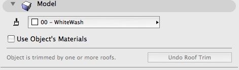

Under the Object's Default Settings dialog box, try checking "Use Object's Materials" if you haven't already. It may or may not work.
