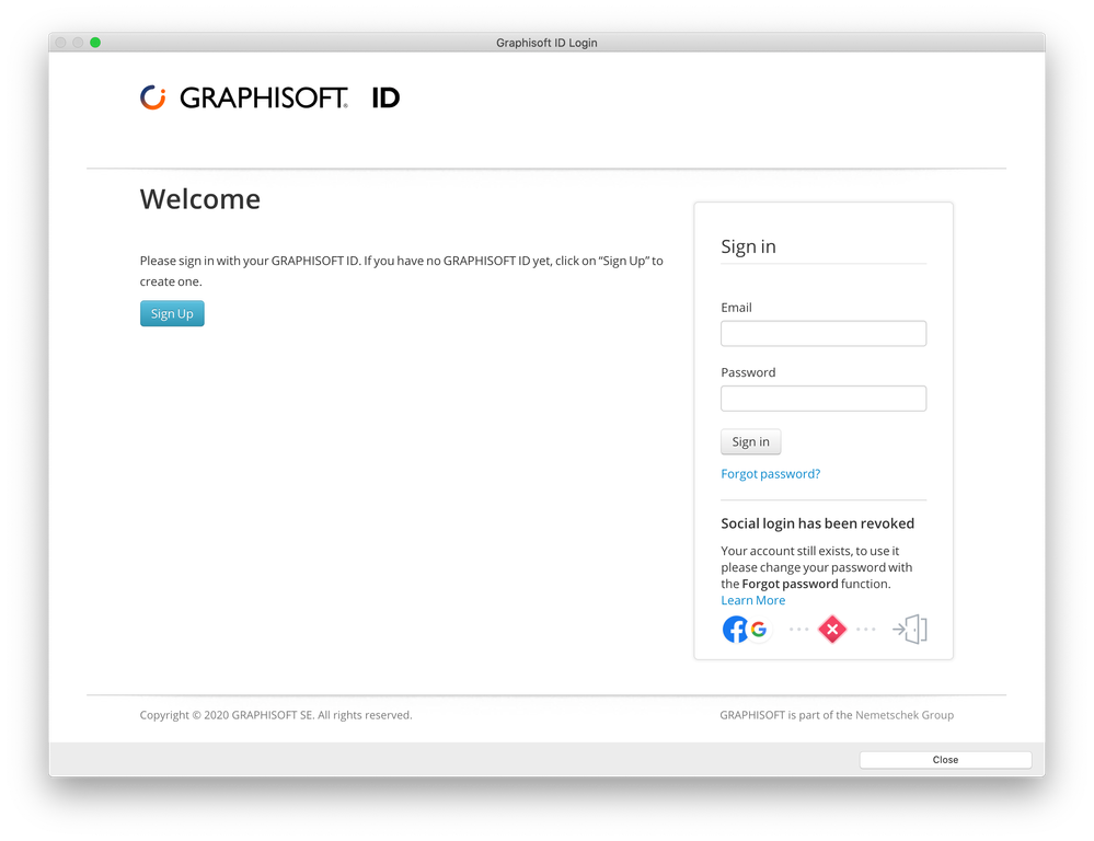

  • If you have a GRAPHISOFT ID (e.g. registration on BIMcomponents or myARCHICAD) but no BIMx account you can activate your BIMx profile by signing in with your e-mail and password.
  • A new registration can be done on the GRAPHISOFT ID site. This account will work for BIMx, BIMcomponents and myARCHICAD. Once the registration is completed with the activation of your account through your e-mail address you can start uploading your BIMx model.
Step 2: Start the upload process Upload works from ARCHICAD in two ways: In both ways you will need to sign in to GRAPHISOFT with your GRAPHISOFT ID account's email address and password:

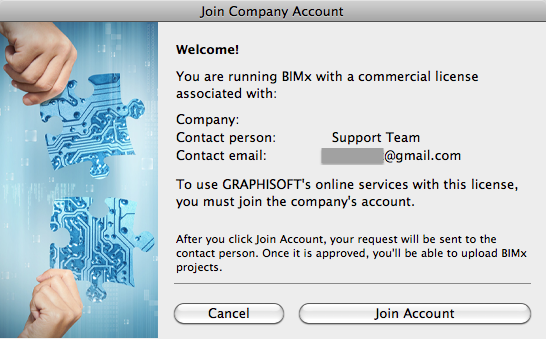

Step 3: Creating a Company Account At the first upload event a so-called BIMx Company Account needs to be created where the uploaded Models will be stored and can be accessed by every co-worker of the Office. Company accounts are created based on the Office's license key(s). The first account using a license key to upload is prompted with the Create Company Account dialog. With creating the Company Profile, this account will be the Owner of this Company account.
Step 4: Joining into an already existing company account If there are additional licenses in an office, other accounts can be added to the existing Company account. There are two ways for joining into a Company account:
  • By requesting access: Try to upload a BIMx model with a different BIMx account but the same license key that has created the Company Account. You will be prompted to Join the Company Account.

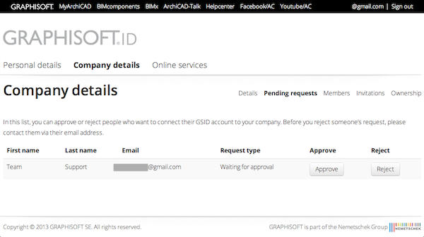

This request can be accepted by the Owner of the Company Account in their profile at the GRAPHISOFT ID site.
  • By invitation: The owner of the Company Account can Invite others to join their Company on the same site, at the Invitations tab.

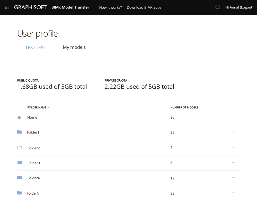

Access Your Account
Your BIMx account can be accessed on the BIMx Model Transfer Site. When a BIMx user account is paired with a Company Account a second tab will be visible besides the User Name. After pairing models will be uploaded under the Company tab. On the site you can manage the uploaded content: organise the model files into separate folders, protect them with password (for SSA users) or send the selected model's direct link to your colleagues or clients.
Users with active SSA can modify the uploaded model’s status between public, unlisted and private.
