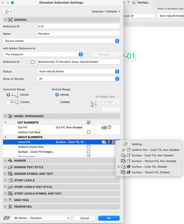

elevations/sections can show surface images, would be amazing to be able to do the same for 3d documents (probably an even more useful uncut appearance than for elevations!)
Available in Elevations:
But not in 3d documents:
