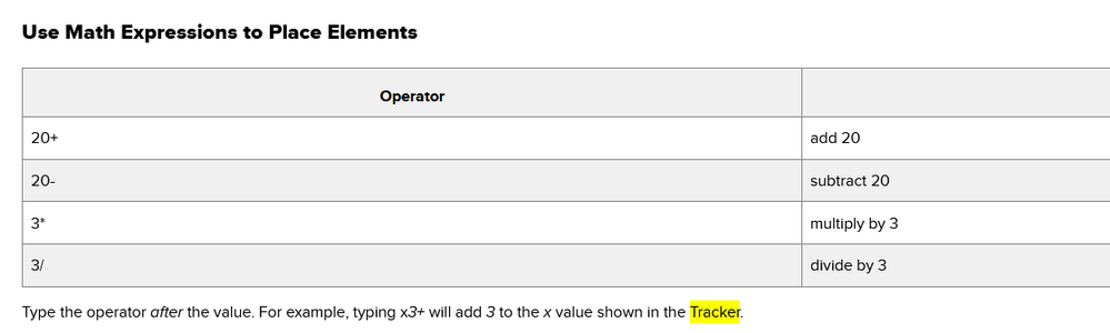

This can already be done now by typing the operator after the value in the tracker.
So in your case add and extra + afterwards ... 0.0625+.5+3.5+0.625+

Each number then + will add to the previous total until you hit ENTER.
rakurs
It is not super intuitive but it works and can reduce errors, actually.
For example, when you click to extend the wall, you can type "2/" to halve its length, and immediately after that "10+" to add 10 to the previous operation. If you do that to a wall that is 100 units long, the end result will be 60 units long. Also, If you move the control point to another snap point but you want the wall to be shorter by 10 units, you hold the mouse snapping to the point and just type "10-".
I got used to it rather quickly and use it daily.

I hadn’t realized multiplication and division had been added to the Tracker in Archicad 27. That definitely covers a good part of what was being asked and, to be fair, makes the original request less essential.
@Barry Kelly , I appreciate you laying out how the Tracker works. Just so it's clear, I've been using Archicad for around 25 years, so I’m familiar with those features — but I genuinely didn’t know about the recent addition of multiplication and division.
