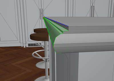

Allow segmentation/3d resolution control for all tools including beams, columns, slabs, walls, shells and imports such as IFC. This should be controllable either through selection settings, work environment and/or a registry entry. This will allow more detailed representation of curved elements which is important for any drawing that utilises 3d (such as sections, elevations, 3d documents) as well as for visualisation. Currently morphs allow segmentation to be increased, and some objects allow 3d resolution to be controlled. Current fixed settings can be quite limiting, especially when it comes to finer detail such as complex profile cornices which require input fills to be manually segmented to allow for decent representation.
Here is an example with the low segmentation causing representation issues for benchtop edges:

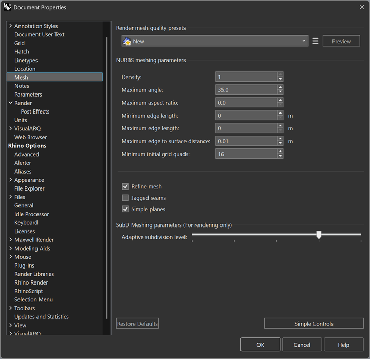

Yes, that's right. It is is different. As I understand, complex profiles are somewhat like NURBS already. NURBS still need to be represented as meshes in a lot of cases anyway with control over segmentation.
This is the window in Rhino:
Currently NURBS are used in Archicad through Rhino imports for instance, however it imports as objects rather than any sort of direct way to edit NURBS. It also allows segmentation control:
