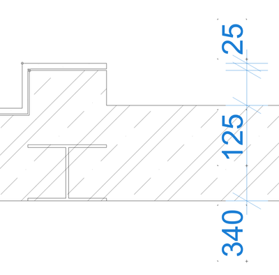

It would beg reat to have more associatibe hotspots for dimensions in stair components. It's kind of frustrating that I can't rely on dimensions I've created in sections for stairs and to be mindfull that I have to check whenever there is a change for the stairs/story height etc which are gonna impact the stair structure:
Sure, as a workaround, I can set offset of the risers/treads to zero and they can be associated for dimension but that is a workaround and that way I can not account for some adhesive material 💁‍♂️
On the screenshot you can see circle and square symbol for the dimension - structure is not associated

Same as with my railing wish... It's such big oversight.
