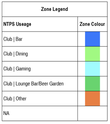

Andrew Swenson
I have created a Schedule that is a "Zone Legend" showing the Category Name and Colour of the zone which I am using to show my Development Application zones to show which areas of the building require car parks.
My issue is that it shows all zones unless I add another criteria to the schedule.  I would have liked to use the Zone Category Code as I have used that to identify all the Development Application Zone Categories but it isn't available as a Schedule Criteria.
Instead I have used Zone Name as the additional criteria to show only zones on a layer that has the DA related zones on it.
It would be helpful if the Zone Category Code could be selected as a Schedule Criteria option.
