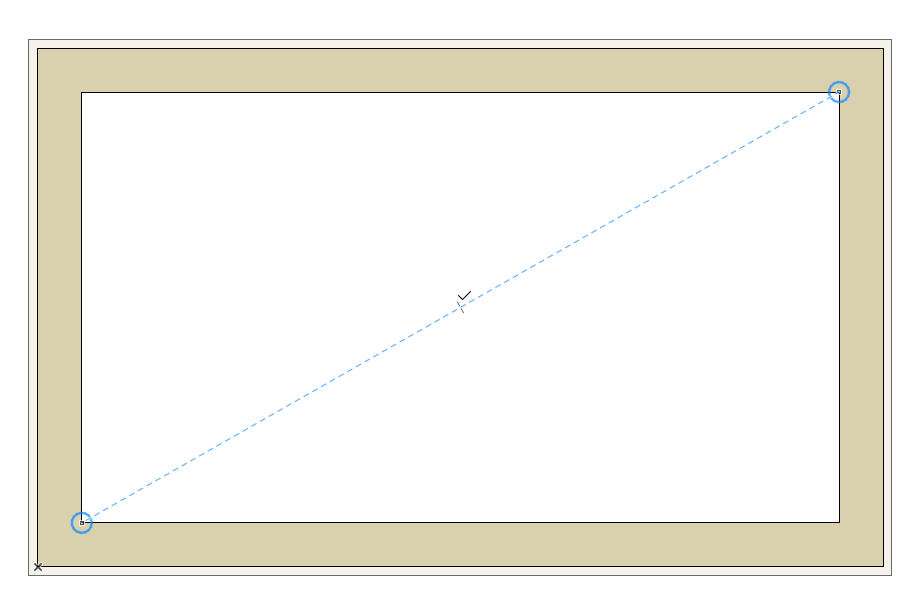

Another way:
1. Make sure "Snap Guides and Points" is enabled, and its "Divisions" option is set to "Half".
2. Hover your cursor over one corner, press Q to place Snap Guide Point (blue circle).
3. Hover your cursor over the opposite corner, press Q to place Snap Guide Point (blue circle).
4. Move your cursor near the middle point of the diagonal between the two. A Snap Guide will appear and its Half Point will be indicated.
5. Click the Snap Point at the half point.
EmmanuelF
Wow, that's even better than the AutoCAD method!!
I searched and asked Archicad's AI help, but it told me to draw a line and then delete it! It works, but it's too time-consuming.
