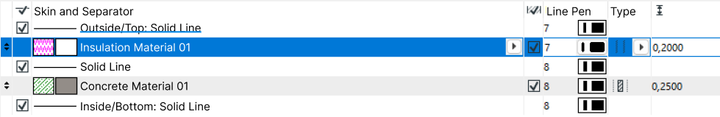

I would like to suggest the addition of Classifications on Composite-Layers and Complex-Profiles-Layers.
Problem:
If we imagine a Composite Wall, with 25cm of Concrete and 20cm of Insulation on the outside.
This is how it looks in the floor Plan:
I would like my Concrete Layer to have Concrete-specific Properties that I can set only for the Concrete Layer. I also would like my Insulation Layer to have Insulation-Specific Properties.

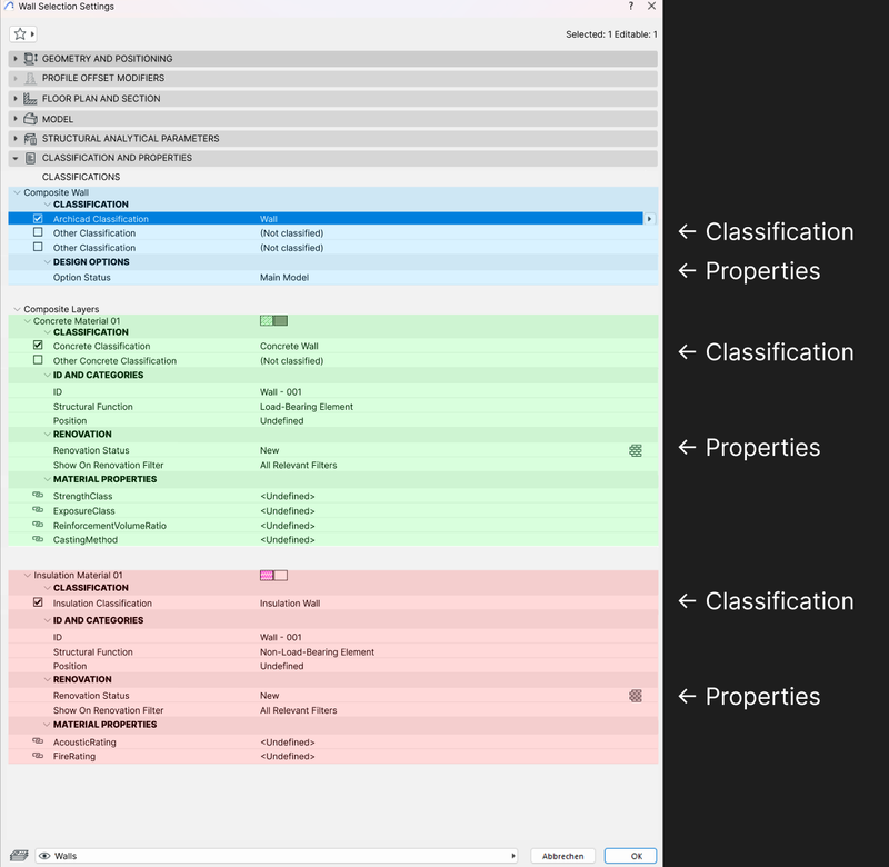

Solution:
Have each Composite-Layer listed within the Classification and Properties tab, and allow for custom classifications for each of those Layers. This is a quick UI Design of how that could look like. Please note that there are fundamental properties that are on each Layer (ID, Structural Function, Position, Renovation Status, Show On Renovation Filter) and there are also specific Properties only for that particular Layer (see "Materail properties" tab within the UI Design)
 (This also solves another Wish which is currently on the Roadmap: Renovation status for composite walls and complex... - Graphisoft Community. That wish is though only a specific need within my bigger wish. My wish focuses on the core problem, missing classifications on composite layers.)
Feedback and Improvements to this design and functionality are always welcome!

Thanks Karoly for the feedback. Actually both ideas are still missing from Archicad. What you are describing is actually composite property inheritance on each instance of that composite. My wish is about setting attributes on a composite layer, not a Building material, very big difference.
Your idea is actually really great and I already posted the same concept somewhere else if I´m not mistaken. You basically want to define properties within the composite Manager itself and just define which properties a given composite instance should inherit and therefore have. The actual set-value tho needs to be on every instance of the wall to avoid having a magnituted of every possible composite-property variation out there. Although having some sort of "default" or "linked" value within each instance of the composite is quite a good idea. That would mean that each instance could "look-up" a value that is set to "linked" where the composite structure and it´s properties were defined.
I might do a UI sketch later this week to illustrate your point better for everyone in the forum, thanks for bringing this up!
