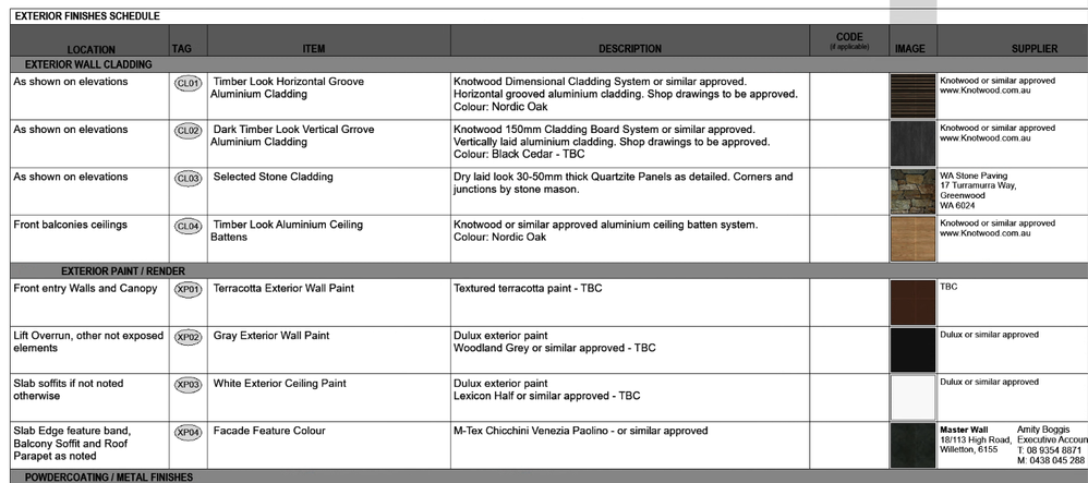

This is actually a much bigger issue.
I don't only want ID's for surfaces, but I want to be able to add custom data fields (similar to properties) to Surfaces.
Why? Because that way I could create a meningful Finishes Schedule.
At the moment the best I can do is I put all the info into the name of the surface in a particular order, then I split the string in a nexpression.
This is a very cumbersome workaround.
If custom data fields could be added to the Surfaces in the Surfaces editor, I could easily achieve the below finishes schedule direct from Archicad.
James B
Thanks @Karoly Horvath  for the example.
Is that example pretty typical with all projects? Do you currently create it completely in excel? Then place as a pdf onto layouts?
@James B
That example is very typical, not only at my current practise bat at every architectural practise something similar must be done.
As for doing it in Excel, I know most practises do, but that is a very error prone workflow, so after all these years
did you learn me as someone who likes errors, re-works and confusion????
No, I don't do my finishes schedules in excel, it is coming straight from Archicad, but with a lot of unortodox workarounds, all of which could easily be eliminated with a little help from you guys... 🙂
I am 100% sure, all Archicad users would highly appreciate a streamlined workflow to produce finishes schedules.
I'm happy to explain how I achieve the above and what developments I think would be necessary to make it more native and intuitive in Archicad, but that might be best in a short video.
