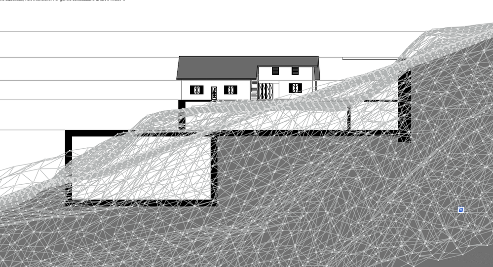

Hi! two years are gone already, but this function is still not available...i'm working on a project where the terrain mesh is gigantic and locking the specified layer is not enough...every single mouse click will select the mesh and as you can image, is impossible to work on it!! please make it happen!!

For this reason I generally work with the terrain mesh layer off, or with it on it's own story.
