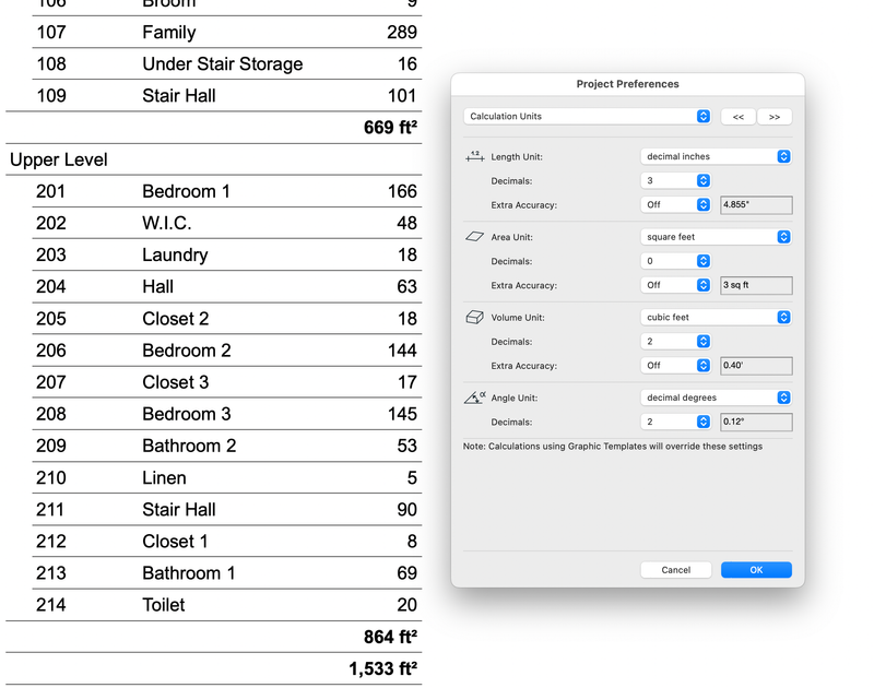

Imagine a world with calculation units per schedule
Wouldn't it be great if FINALLY we could set calculation units PER schedule. It's insane that in 2023 2026, we still can't do this. Some schedules need to round to the nearest whole number, other to the nearest 10th, etc. WTF. This should so obviously be part of dimension styles. And should have been for the last decade plus.

If memory serves, labels also follow the rules set in this panel, rather than dimension style preferences. So if you label an element to show some dimension, it will default to what is in this panel.
Obviously just being able to use the dimension preferences linked to a saved view is the logical solution.
We have a sort of workaround, but you lose the ability to add the values: custom properties that convert certain dimensions to a text string:
STR ( STRTONUM ( STRCALCUNIT ( {Property:General Parameters/Elevation to NAP} ) ) / 1000; 2 )
This converts from mm to m with two decimal points. Just swap out the 'Elevation to NAP' with whatever dimension parameter you wish and remove the divide by 1000 for the imperial unit stuff.

You can also set the property to a 'number', but this defaults to what you set in Working Units as 'Numbers without Units'. For example font size. Typically you want two decimals for those. These you can add up.

Oh... I totally agree! What is most upsetting is that this is a basic feature that could be solved many versions before. That is a problem associated to this one: the general parameter "width" don't follow "Calculation Units" in maps, instead it follows "Dimension Styles"... How could this happen...

As well, we should be able to control unit types per dimension string element.
I sooooo often want to show feet and fractional inches and Inch's in the same detail.

IMO, calculation rules should be part of the dimension style settings, so that we aren't setting them per viewpoint, but per view. Not in the schedule scheme settings, but in the schedule view settings.

I suggest we take this request one step further to allow the setting of units wherever they are displayed. It is common for different dimensions in the same view to need different units or different precision. Likewise for columns within a schedule. And when expressions produce numeric values it would be great to set their units directly instead of having to code that into the expression.
