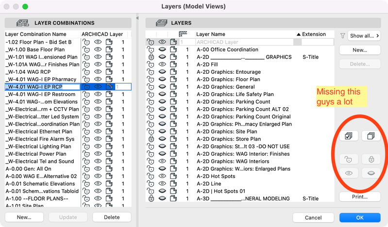

This is what we got
Missing options:
1. Using Folders to control visibility, priority, lock, properties? . Main problem with this is that a layer can only reside within one folder so this has to be implemented in the Layer Combination side.
2. Click to rename Layers needs to return
3. Select All - Unselect All, Lock - Unlock, Hide - Show buttons need to come back.

And no folders for Layer Combinations?
Eduardo Rolon
Glad that they could n't get to screw them up in 26. But true regular folders there is one of the places that they would help. I mean REGULAR working folders not these.

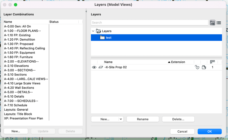

DGSketcher
Legend
It was said many times in the Beta that for attributes we should have complete hierarchical folder views, NOT this horrible display of folders with sub-folders in a separate box which doesn't work. Why are GS trying to reinvent the wheel? Trying to manage layer setting for a combo using folders is a complete pain with the current arrangement, it means things are no better than AC25 as you still have to use the list view. Implement the hierarchical view properly and you could do away with the list and implement parent folder visibility control.

As I mentioned above the splitting of the view icon from the other three is stupid. Today I am working through updating my template. I work use the WE setting "Locked layers are hidden in popups". The number of times I have turned on a layer and missed that the layer is locked is so frustrating. If the icons were together there would be less chance of this happening. 😠

Anyone else spotted the strange contradiction that you can dbl-click to rename a layer combination but you have to select the option to rename for layers. 🙄
Eduardo Rolon
It is worse.
You can click to edit the Layer Extension but not the name.
But as they wrote when the bug was submitted:
  1. Click to edit Layer Name will slow down the search
  2. Click to edit the Layer Name is reserved for Folders
