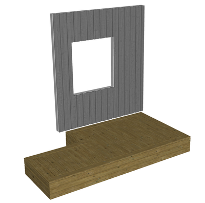

The "Accessories" add-on links objects to walls, roofs or slabs. The "Interior wizard" add-on links objects to zones. The objects will still be objects, not windows or doors. If you move or resize the wall, slab, roof or zone, the object moves and adjusts its size and/or position accordingly. However, these objects need to be scripted as special "accessory objects".
I've scripted a few accessory objects myself since the GS Accessory library isn't that extensive.  I've mostly made different cladding and roofing materials since that is what I needed, but of course anything can be linked. The add on provides you as a GDL programmer with information about the wall, slab, roof or zone. Information such as geometry, number of openings, wall direction etc. Given the information you receive, you can create objects associated to these building elements.
I realize this is not an option if you are not skilled in gdl-programming, but since code snippets have been posted here I thought it could be worth mentioning.
Here is a picture of a wall siding object and a wooden deck object I've made. If I stretch the wall or change the shape of the slab beneath the deck, the objects will rebuild to adapt to the new geometry:
