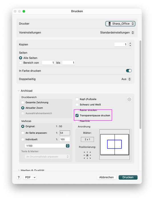

Trace Reference is one of Archicad’s most powerful and distinctive tools. It allows for highly precise multi‑level and multi‑concept design by overlaying drawings from other stories, views, or layouts. The graphic clarity it offers in plan is exceptional.
However, the Trace Reference is currently non‑printable, which often feels like a missed opportunity.
Many times, I simply want to print or export exactly what I’m already seeing on screen—including the trace reference—without recreating its appearance via graphic overrides, custom fills, duplicated views, or complex workarounds.

But the Trace Reference is printable?
Yes, the Trace Reference is indeed printable and also publishable when publishing as PDF.
The only thing missing is the ability to specify that a Trace Reference along with its settings is optionally stored/not stored in the definition of saved Views.

Thanks for the hint, I actually never noticed that as I never print straight from the View and I don’t see that dialog often.
Still I’d love very much to be allowed to save an overlay into a View, and use it as I wish. It would be so handy!
The setting to print the reference is there when you publish as well.
And each view will remember what you set as the reference.
Except for the plan views that will all be the same particular trace or can be set as storey above, storey below or previous story.
