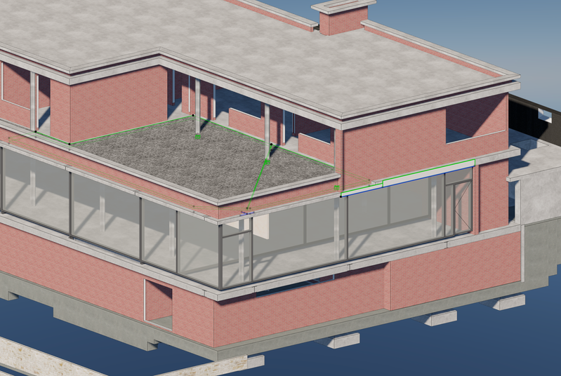

I often fight with these situations in which I set Partial structure display to show core of the composite/profile elements to be able show part of the building but often get elements that are single building material such as roofs, walls, slabs etc that are then hard to hide.
As you can see selected elements on the screenshot such as roof which creates sloping part of the roof terrace or a beam which is a plaster that I was not able to correctly connect walls from two stories.
Similar to a wish to being able to set PSD for stair's risers/treads (already on roadmap), it should be ale possible to set PSD for these single building material elements.
I'm thinking for two ways how it could be possible
1. Option to set in element
2. Option to set in building materials (some materials are alway surface/others/core 💁‍♂️)
It coudl probably be both in a way that the second is primary and the first is possibility for user to override this. This being set, it would also require to adapt composite/complex profiles behaviour.
