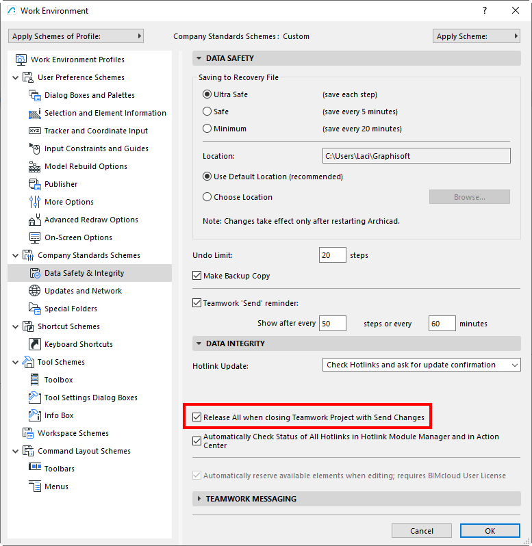

How would this proposed option be different from the existing "Release All when closing Teamwork Project with Send Changes" option available in the Data Safety & Integrity page of the Work Environment Dialog?
